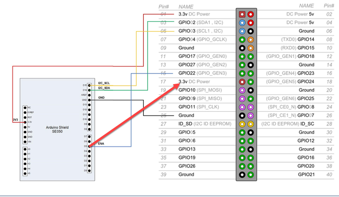

Hi Team,
I am facing an issue while trying to communicate with the SE052F over I2C using the Plug & Trust Nano Package.
According to the AN14277 application note, I configured the SCP03 keys as follows:
ENC Key: 3ae441c747e32ebc16b3bb2d843c6dd8
MAC Key: 6c18f3d08fee1cb96a3c8de5d3538aaa
However, Se05x_API_SessionOpen consistently fails.

Hi @krsuresh ,
Since you are testing this on Raspberry Pi , did you also test with the full version of MW? Did it work anyway? Please kindly clarify.
Kan

Hi @Kan_Li,
Thanks for the quick response.
I used the following configuration during the simw_top build, and while se05x_GetInfo runs successfully, se05x_Minimal fails; the log is provided below.

Hi @krsuresh ,
Did you really rebuild the MW with the following options?
PTMW_ SE05X_ Ver = 03_XX
PTMW_SE05X_Auth = PlatfSCP03
From the log, there are some conflicts:
sss :INFO :Compiled for 0x70200. Got newer 0x70216
sss :WARN :Communication channel is Plain.

Hi @krsuresh ,
Thanks for the info! Seems the platformSCP keys used in your test are not for SE052F, would you please configure the keys according to the guide in SE-PLUG-TRUST-MW_04.07.01/simw-top/doc/appendix/platfscp.html?
Hope that helps,

Hi @Kan_Li,
Thanks for the update. Yes, the MW is working fine now after configuring the correct PlatformSCP keys. However, I noticed something unusual: the Plug & Trust Nano package samples are also working now without any code changes, even though they were failing earlier. I’m not able to understand how they started working suddenly. Could you please help clarify what might cause this behavior?

Hi @Kan_Li,
I am testing two new SE052F boards. On the first board, the Plug & Play Nano package sample initially failed, but after running the Middleware sample once with plain_scp.txt, both Middleware and Nano samples started working correctly.
However, when I switch to the second new board and test the Nano package, it fails. After that, when I switch back to the first board, the Nano package also fails again. It seems that running the Middleware sample with plain_scp.txt is required each time to make the Nano package work.
Could you please help clarify why the Plug & Play Nano sample behaves inconsistently when switching between different SE052F boards? Is there any configuration or reinitialization needed for each board before running the Nano package?
Sureshkumar R
10,561件の閲覧回数
Kan_Li
Hi @krsuresh ,
How did you connect SE05x with the raspberry board? If you connect them via wires, maybe you can connect the RST pin to VCC directly to avoid the SE hold in reset.
Kan

krsuresh
Hi @Kan_Li,
I have tested the setup by connecting the RST pin to VCC as suggested, but the issue still persists. Additionally, I have observed that when I run the Middleware sample first, both the Middleware and the Nano package function correctly. However, after disconnecting and reconnecting the power to the SE052F board, the Nano package fails to work again.
Sureshkumar R
