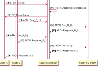

1. I have tired running multiple client requests (with Auth=None) at the same time with the access manager and each time I observe that the calculations/operations are done in a blocking manner.
Below is an image snippet from the document (access manager section) showing multiple client requests at the same time. I could observe that the interaction between the access manager and the secure element seems to be always blocking/synchronous in nature.
Could you help me know if this is the case always that the operations are blocking in nature. If true, then increase in number of requests AT SAME TIME, would increase the time taken. Right?
Also let me know if there is a way to enable asynchronous communication between the access manager and the Secure Element to improve the performance if at all it is possible?
Does having an auth based user sessions enable asynchronous communication? No?

any access to the SE always is blocking until the SE has processed the command. The SE can always only process one command concurrently. The access manager only takes care that the SE only gets a new command sent when the previous one has finished the processing.
So when two requests are sent at the same time one of them needs to wait until the first one has finished processing. One request is always one APDU (command), one SSS call can create multiple APDUs.
There is no asynchronous communication foreseen in the MW. An asynchronous implementation would also not improve the final application performance as anyway the application typically only can continue when the crypto calculation result is available.

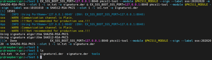

I am trying to run sign operations using pkcs11-tool tool with SSS library in parallel.
I am running below two commands on my i.MX6 with SE in parallel.
pkcs11-tool --module /usr/lib/libsss_pkcs11.so --sign --id 88881000 -m SHA256-RSA-PKCS --slot 1 --input-file /tmp/data1 --output-file /tmp/data1.sig &
pkcs11-tool --module /usr/lib/libsss_pkcs11.so --sign --id 88881001 -m SHA256-RSA-PKCS --slot 1 --input-file /tmp/data2 --output-file /tmp/data2.sig
Note: Assume the data and keys are pre-generated.
I observe that most of the time this operation fails with below error and only somtimes passes.
error: PKCS11 function C_SignUpdate failed: rv = CKR_FUNCTION_NOT_SUPPORTED (0x54)
Could this be a timing issue?
Note: Same Image also attached if this screenshot is not clear
I did some trial and errors by running multiple asymmetric operations in parallel.
Following are my observations.
1. If same asymmetric operation is run in parallel, example RSA_SHA256 and RSA_SHA256, it runs into  above error most of the times. Rarely succeeds.
2. If different asymmetric operations are run in parallel (Example: RSA + ECDSA or RSA_SHA256 + RSA_SHA512), it passes most of the time. Sometimes fails.
Do you know why this might be the case?

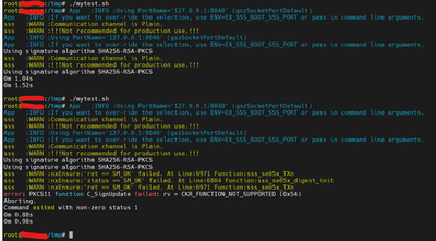

For the case of RSA_SHA256 and RSA_SHA256, it is quite sure due to the digest collision , but for the second case such as RSA_SHA256 and RSA_SHA512, I could not reproduce it here, do you have log about it? This case works well from my side.

I am able to reproduce the issue with different SHA* scenario.
Please do the following.
1. Copy the attached shell scripts to your machine ( test.sh and rsa_sign.sh).
2. Make them executable chmod +x test.sh rsa_sign.sh
3. run ./test.sh
You would need to adapt the rsa_sign.sh accordingly.
Let me know your observations.

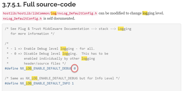

We are still trying to reproduce the pkcs11 failure as you met but not succeeded yet, so it would be helpful if you may provide the complete logs from the client applications, by enabling the debug log option as shown below:

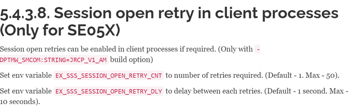

BTW, have you ever tried with an extended retry interval as mentioned below? I am not sure if it is your case, but just suspecting if one client's operation lasts too long to keep another wait.
