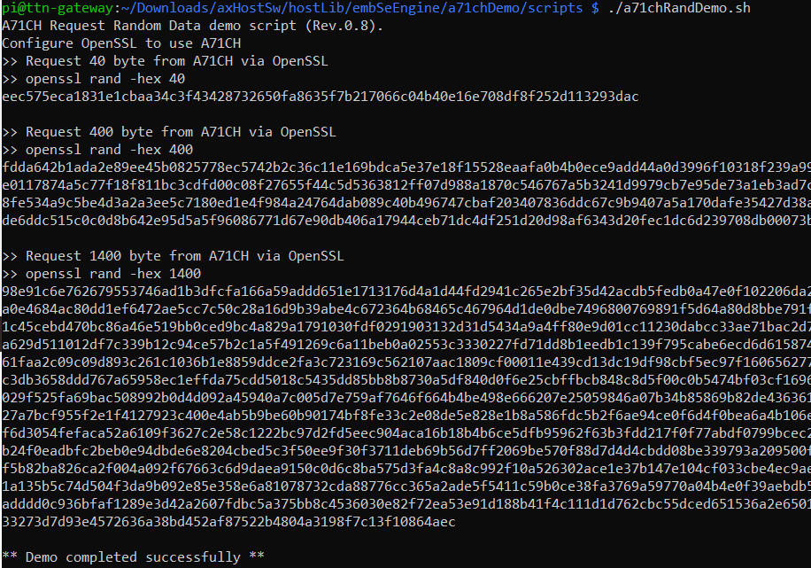

I actually ran into other issues meanwhile with the software package trying to det up the OpenSSL engine:
(Let me know if I shall instead open another ticket for this):
>> unable to compile the A71CH_LINKED_ENGINE as indicated on the Doxygen documentation (recipe fails)
>> recipe fails regardless of the specified build platform with sm_types.h ax_api.h apparently not linked properly in the Makefile under the /linux subfolder.
Using the library built with the A71CH_ENGINE parameter instead and linking the openssl .cnf file under /etc/ssl/, the a71CH generated libraty under /usr/lib and setting up export OPENSSL_CONF= /etc/ssl/<a71ch_openssl.cnf> does not appear to work.
When running the ./a71chRandDemo.sh Openssl runs as if no a71ch (no connect attempt) was present and no activity is measured with the logic analyzer on the I2C bus (example from hostLib/embSeEngine/a71chDemo/scripts/):
(Followed axHostSw/doc/a71chDoxy/html/page_imx6ul_setup_openssl_engine.html guidelines)
I guess this has to do with the openssl v1.1.0j being installed while the libdev v1.0+ was used for compilation (the Host SW package does not support openssl V1.1+). I will try to see if a downgrade is feasible.
