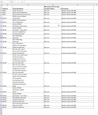

Dear support,
customer Bosch is  observing a FCCU state transition failure after the reset due to FCCU FLL fault and as a solution they will be performing destructive reset if any FCCU fault is identified.
But they  have a software where, the destructive reset implementation solution is not applied. In that software the reset’s will be in loop till the FCCU FLL fault recovers. FCCU can capture 72 faults as mentioned in the reference manual. So they request to generate a customer tailed summary FMEDA where fault mentioned as not "sure are" below are not considered for the FMEDA
Viktor
438 Views
antoinedubois
HI Viktor, I have emailed you separately on this issue. We do not provide Customized FMEDA, but we can support customer to do it on their own.
