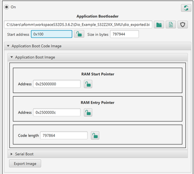

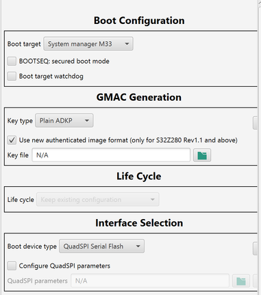

  2. Created an IVT image using the S32 IVT Tool
    • Selected the LED example application (which works when debugged via Lauterbach).
    • This is the configuration:
  • After configuration, I pressed the "Export Image" button in the Application Bootloader section to update the image blob.
