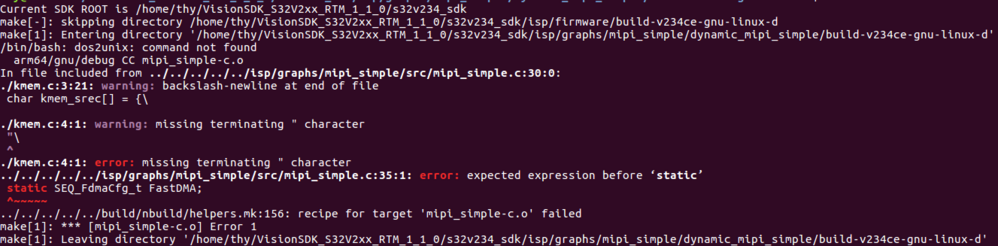

   Hi , I followed the tutorials in Quick-Start-Packages and I had create BSP with VSDK support, but when I was tring to compile demo examples I got some error messages, I had shot the screen .Would anyone like to help me to solve the problem or figure me out what is wrong with that, thanks very much.

KushalShahNXP
Hi Heyi,
This example uses isp graph "mipi_simple". Can you please try to compile it separately at "VisionSDK_S32V2xx_RTM_1_1_0\s32v234_sdk\isp\graphs\mipi_simple\dynamic_mipi_simple\build-v234ce-gnu-linux-d"
Also make sure that you haven't made any changes to the original code and all environment variable are populated correctly.

heyitan
Hi Kushal, I just tried to build compile the isp graph "mipi_simple" separately at
Unfortunately, I got a similar error message as before, the error were still from "kmem.c", I am sure the source code remained unchaned and this time I tried this on another computer.I also posted the question on the ticketing system, will that system offer better technical support?
