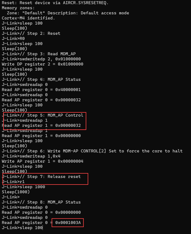

I tested it with this j-link script, and everything works correctly.
// Step 1: Connect
device S32M244
si SWD
speed 4000
connect
sleep 100
// Step 2: Reset
R0
sleep 100
// Step 3: Read MDM_AP
swdwritedp 2, 0x01000000
sleep 100
// Step 4: MDM_AP Status
swdreadap 0
swdreadap 0
sleep 100
// Step 5: MDM_AP Control
swdreadap 1
swdreadap 1
sleep 100
// Step 6: Write MDM-AP CONTROL[2] Set to force the core to halt
swdwriteap 1,0x4
sleep 100
// Step 7: Release reset
r1
sleep 1000
// Step 8: MDM_AP Status
swdreadap 0
swdreadap 0
sleep 100
The core is always halted after the reset is released:

5,479 Views
waldluis
Hello @danielmartynek
Thank you for your quick and helpful response.
I could reproduce your script with the J-Link on my eval-board.
The main difference was the communication speed. I had it set to 1 MHz, which works fine except when stopping the CPU. After changing this for the stop process, this works every time. Is the communication speed specified in any datasheets? It seems to be a crucial factor in the process. The J-Link also fails sometimes at 1 MHz.
With the proprietary device I use, the debug request with the MDM_AP has no effect. The only way to stop the CPU is by modifying the DHCSR directly. I can't explain why, but that's fine as it now works every time.
