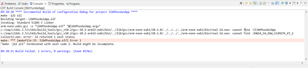

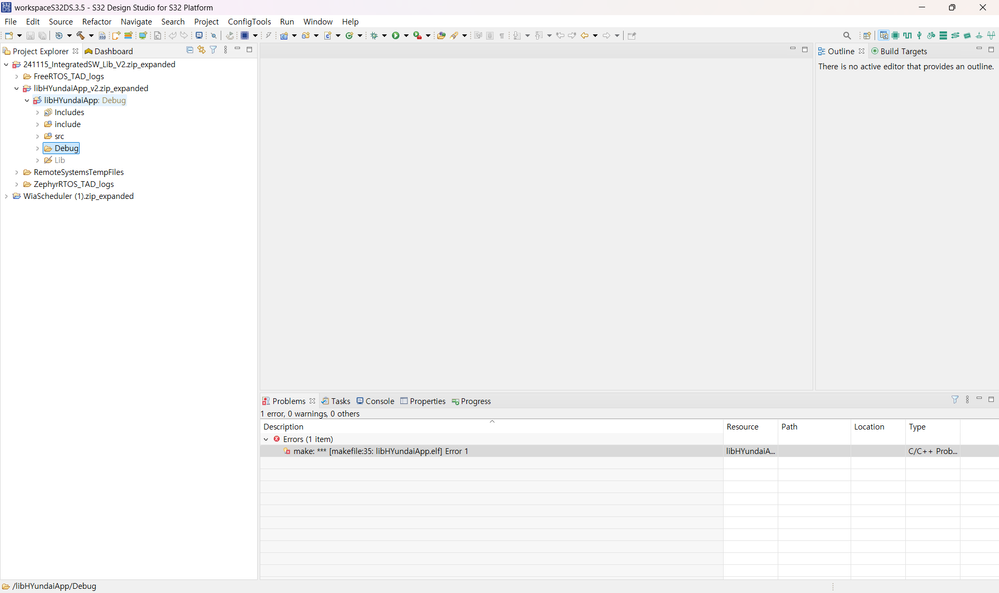

I want to know why error like the picture appears.
Also, what should I do to solve this error?

Hi @bh_lee,
Firstly,
Could you please provide more details about how are you opening this project?
Is this an imported project from another version? If so, please check that the same S32DS version is used, since there are some differences in configuration that might affect build processes.
Did you create a new workspace and then open the project from another workspace? Or did you copy the project directory to the new workspace and then load existing project?
Did you use the import existing project wizard? Did you try a Clean Build command first?
By the screenshots, it seems that there are some undefined references to llibHYundaiApp IHWIA _SA_ASW_S32M276_V72. I suppose these are libraries, please check for includes in the properties of your project:
If possible, please share your project to test this on my side.
