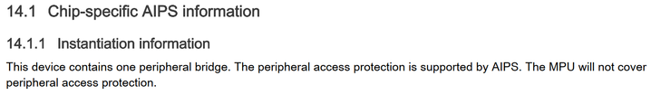

Hello @Satyajit_Patil,
Are you currently experiencing this issue with MCM_PID writes, or was that just provided as an example?
For the S32M24x series, the MPU does not protect peripheral registers. However, I’m not entirely certain about the MCM, since it resides on the Private Peripheral Bus (PPB). Let me confirm that and get back to you.

Satyajit_Patil
A few more inputs on this topic -
1. I am not changing any debugger privileges in region zero.
2. No other system level operation than clearing the interrupt flag can be done inside ISR.
3. I am not using core MPU but controller's MPU (by nxp)
