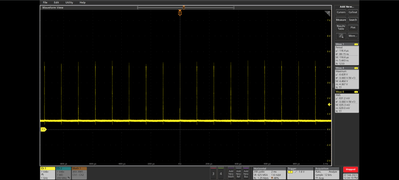

Hi @Satyajit_Patil
Could you please check the reset signal using an oscilloscope? Measure the reset pin directly and share an image of the waveform you observe. We expect to see a signal similar to the one attached, with the reset line toggling as shown.
Additionally, could you try a process that has worked for me and other customers experiencing similar behavior? To re-flash your MCU, keep the reset button pressed while trying to flash it with a blink example. It might fail and ask if you want to retry. When that happens, release the reset button and then try again to load the program under that prompt. After doing this, the program should load successfully and the board should recover.
If the issue persists after trying the steps above, please let me know.
BR, VaneB
