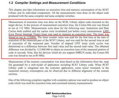

A. according to RM of S32k1xx, maximum frequency for LPIT BUS_CLK which can be CORE_CLK/2, but in SCST library user manual LPIT is driven by 112MHZ in HSRUN(equal to CORE_CLK). is that correct?

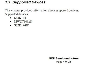

B. in SCST user manual, supported devices are listed:
are the all documents valid for s32k146 or s32k142?
