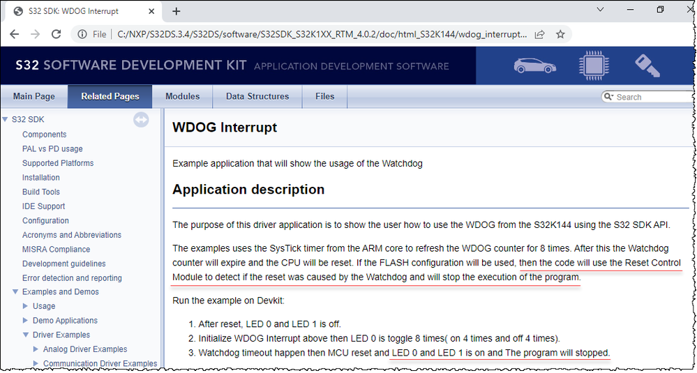

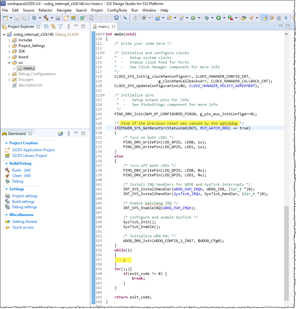

Robin_Shen
According to the Application descriptionIf the FLASH configuration will be used, then the code will use the Reset Control Module to detect if the reset was caused by the Watchdog and will stop the execution of the program.
WDOG Interrupt Application description.pngWDOG Interrupt Application description.png
After reset caused by the Watchdog(line 128), user can add a flag in it. And then you can add your own function in while loop according to flag.

Lily_31_amz
Hello Robin,
yes this example was taking from the SDK, the watchdog functionalities is correct, after 8 cycles the MCU reset and stopps.
is there a way after a reset happens, to restart the board automatically ? and eventually check in a register if the reset was done correctly ?

Robin_Shen
