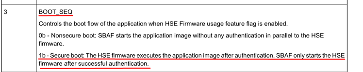

My understanding of your response to Question 2 :
when BOOT_SEQ == 1 and APPBL verify OK ,coreX(X according to IVT_BCW config) will run from APPBL(0x30 in IVT).
when BOOT_SEQ == 1 and IVT is valid ,coreX will run from "CM7_x Application reset address" in IVT ,Did I understand it correctly?

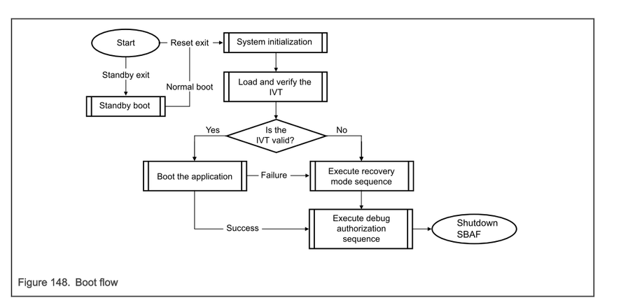

Hmm, this is some SW implementation as uC only refer to IVT for boot. If that is the case please refer to the documentation of that SW.
uC scans for valid IVT starting from lowest address and boot one it find it.

Hard to say, this is SW implementation.
From HW point, the device will scan for IVT. once it find it process it and set boot according the settings in IVT. After it it will jump to address of cores in IVT and leave reset. Further on it is all in hands of SW, so for every application it will be different..
Usually you will always use the bootloader in IVT, and will perform branch to application from bootloader by SW.

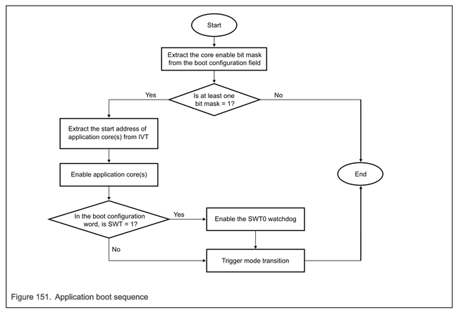

1. Under what condition does the S32K3 choose to start CM7 with the address configured in the IVT?
See the boot flow: If the IVT is valid
2. There are multiple addresses in the IVT, such as "CM7_x Application reset address" and "Pointer to APPBL". What are the differences between them?
CM7_x Application reset address - It is where you want to start the application after reset
Pointer to APPBL - it is where you want to start the code in case of boot loaded.

4. Should the above mentioned addresses point to AppBL Header Tag(Magic number 0xD5) or  AppBL content(app executable code)
Could you elaborate closer? I do not understand what you mean.
IVT will always point to your startup code of whatever application you run.

Thank you for your reply , I have a follow - up question:

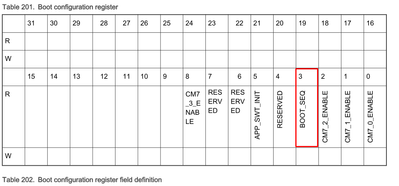

zxdd
Correction to my previous response:
when BOOT_SEQ == 0 ,coreX will run from "CM7_x Application reset address" in IVT .
