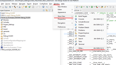

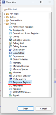

I am not able to see Embedded Registers of S32K344 MCU for debugging in S32 Design Studio 3.5
Like their is embedded register view in S32 Design Studio 3.4, which view we have use for seeing peripheral registers values of a MCU
327 Views
petervlna
Not sure what you mean by embedded registers. All of them are embedded into uC.
And once you enter debug mode, you will see the registers in this window:
