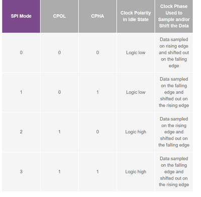

hi community as we know  in spi we have 4modes while iam reading the s32k data i got little bit confuson if any one knows revert me
spi 4 modes modes

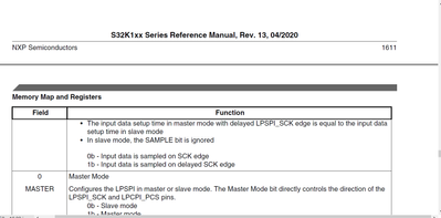

but in data sheet they mentioned like this so iam confused which i have to choose in above modes

clock/phase polarity is selected in Transmit Command Register (TCR). Refer to TCR description in the RM.
