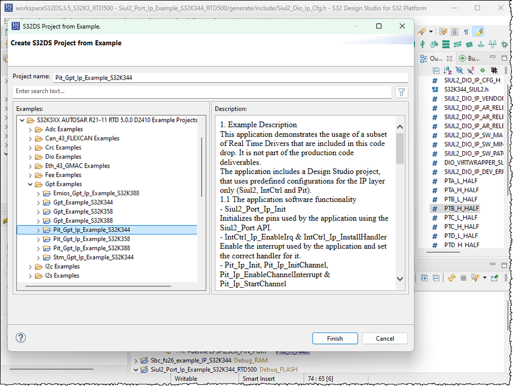

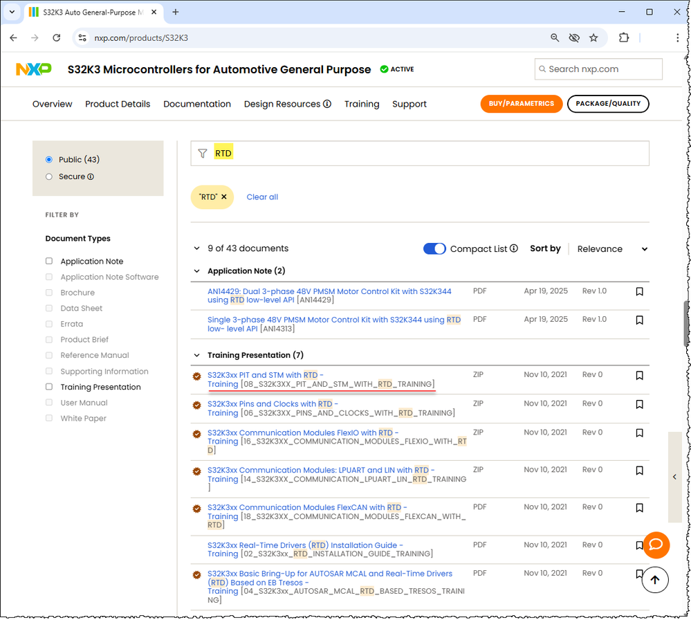

Robin_Shen
Here is a brief introduction to the PIT timer and how to use the function in RTD.
If you have installed S32K3 RTD, examples can be found by clicking File -> New -> S32DS Project From Example
As you know, S32K3 has many derivatives, so to reduce effort, in the most recent RTD releases we only provide examples for K344, K358, and K396.

Robin_Shen
Did you download the 08_S32K3xx_PIT_and_STM_with_RTD_Training.zip?
By the way, there are Gpt examples in S32K3 RTD 5.0.0, for example: Pit_Gpt_Ip_Example_S32K344
