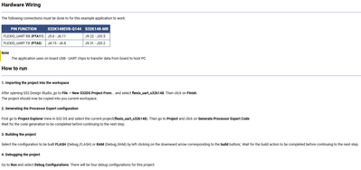

Currently working on S32k148evb board,  Can anyone tell e steps to verify the output of the program FlexIO UART Example Code. How to verify it on development board and by using serial monitor TTL converter? In real tie expression also. Please provide steps.

Hi @Turtledove,
From your other community post, I assume you are using S32DS for ARM with the SDK, is this correct?
You can find the example descriptions under your S32DS installation (C:/NXP/S32DS_ARMv2.2/S32DS/software/S32SDK_S32K1xx_RTM_3.0.0/doc/html_S32K148/flexio_uart_s32k148_group.html).
The example uses two instances of the FlexIO UART driver are used to echo the data received from host. Here are the connections and steps to run:
The example configures the terminal with these settings:
  • 115200 baud
  • One stop bit
  • No parity
  • No flow control
Lastly, as I've mentioned in your other post, for Real-Time Expressions, please refer to this thread: Solved: How do I enable Live View for variables when debugging? - NXP Community.
