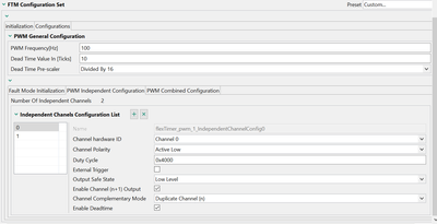

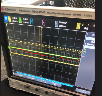

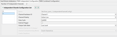

alice_th
hello @danielmartynek
when i set with dead time, ch1 don't have waveform output, could you help to check it
look at ch1 with green line, no pwm output
2,945 Views
danielmartynek
Hello @alice_th,
This is not related to the topic of this thread.
Please create a new one.
Thank you
