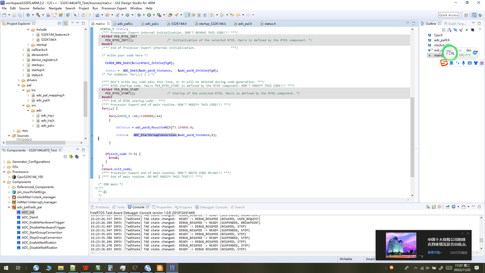

Haoyun
Why can my ADC only get one result?
3,623件の閲覧回数
Robin_Shen
Hi Haoyun,
Note: When Software Trigger mode is enabled, configuring control channel index 0, implicitly triggers a new conversion on the selected ADC input channel.

Haoyun
Why does my program enter the default isr when running to adc_stargroupconversion()  thank you
