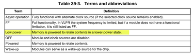

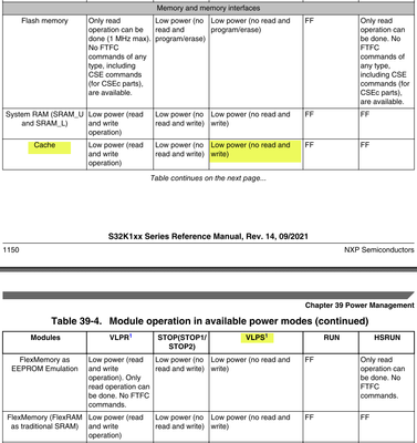

I use cache enable using below cmd after reset.
LMEM->PCCRMR = 0x80000000U;/*Only R0 region is cacheable*/
LMEM->PCCCR = 0x85000001U;
Other LMEM register is used reset value.
[Questions]
When cache is enable and MCU transitions to VLPS->RUN,
Do I need to any register operation for chache ?
2,045 Views
lukaszadrapa
The content of memories (including the cache memory) is retained. Let me share some screenshots from the reference manual:
Lukas

lukaszadrapa
Hi @Hirofumi
this configuration is kept during the VLPS, no configuration is needed.
Lukas

Hirofumi
Hi lukas,
Thank you for supporting.
Will the data that was read into chche memory be keep in VLPS mode?
If no, Should I need to execute invalidate cmd after transit VLPS -> RUN?
2,046 Views
lukaszadrapa
