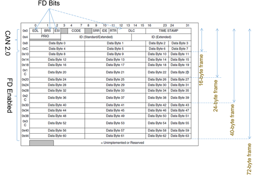

How many CAN message frames is stored in a particular Message Buffer??
This number not mentioned in RM.

What i want to understand is deep of a particular MBs??
Suppose I configured 1st MB of CAN1 to receive only CAN ID 0x01 then how many CAN frame it store without being lost.

Hi@KKumar
just one,one MB can just store one frame each time.
if  a new message comes from outside, the MB's code area will tell there is free to receive or not.
you can take a look at the chapter 55.4.3 Message buffer structure(S32K-RM Rev 13)
  -CODE — Message Buffer Code

Hi@KKumar
      The Message buffer structure can represent standard frames (data length of 0-8 bytes) and extended frames (data length up to 64 bytes) of the CAN 2.0 protocol. Each independent MB consists of 16 or 24, 40 or 72 bytes, corresponding to 8 or 16, 32 or 64 in the number of massages;
