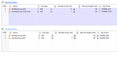

I am facing the same Issue with driver Crypto_43_HSE v6.0.0 (Crypto_43_HSE_TS_T40D34M60I0R0) on S32K312 and I am facing the exact same issue.
I successfully formatted the key catalogs, and I can see that after that the HSE Status is reported as 0x0B60 so CUST_DEL should be active.
In the NvM and Ram Key Catalogs I have the following configuration:
but I get
HSE_SRV_RSP_INVALID_PARAM when I try to do KeyElementSet to initialize the key.

Well, there's no problem with the life cycle. Your device is still in CUST_DEL.
Could you show me how are NVM and RAM catalogs defined?

Thank you for your reply; I have attached the EB configuration file and some screenshots

Thanks for your help. Problem solved! Much appreciated.

hangwu
/* Table containing NVM key catalog entries */
const hseKeyGroupCfgEntry_t aHseNvmKeyCatalog[] =
/* NvmKeyGroup_0 */
{(HSE_MU0_MASK | HSE_MU1_MASK), HSE_KEY_OWNER_CUST, HSE_KEY_TYPE_AES, 10U, 256U, {0U, 0U}},
/* NvmKeyGroup_1 */
{(HSE_MU0_MASK | HSE_MU1_MASK), HSE_KEY_OWNER_CUST, HSE_KEY_TYPE_ECC_PAIR, 10U, 521U, {0U, 0U}},
/* Marker to end the key catalog */
{0U, 0U, 0U, 0U, 0U, {0U, 0U}}
/* Table containing RAM key catalog entries */
const hseKeyGroupCfgEntry_t aHseRamKeyCatalog[] =
/* RamKeyGroup_0 */
{(HSE_MU0_MASK | HSE_MU1_MASK), HSE_KEY_OWNER_ANY, HSE_KEY_TYPE_AES, 10U, 128U, {0U, 0U}},
/* RamKeyGroup_1 */
{(HSE_MU0_MASK | HSE_MU1_MASK), HSE_KEY_OWNER_ANY, HSE_KEY_TYPE_ECC_PAIR, 10U, 521U, {0U, 0U}},
The root cause of my error is the absence of the RAM marker(/* Marker to end the key catalog */)—I simply never configured ramKeyCatalog, and it turns out this entry is mandatory.
