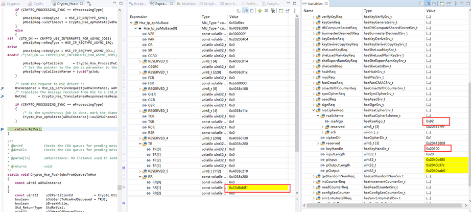

Hi Team
I tried request an RSA encryption action on HSE_B module in S32K312. But response an Error code from MU
Some details as below:
  • Ver of HSE: HSE_0_2_1_0
  • Algorithm: RSAES PKCSv1.5
  • RSA public key stored in RAM and imported before request encryption.
  • Data wait for encrypt is a HASH which calculated by SHA256.
Any hint to this error code?
Thank you.

Hello @AquariusXo,
There are some potentials that can cause the HSE_SRV_RSP_GENERAL_ERROR as:
1. Use wrong key slot.
2. Use key has size is bigger than "Max key length in bits" of key slot.
Dan

Thank you @DanNguyenDuy , the cipher method refer to a RAM key slot and the issue is gone when we re-provide the RAM key.
