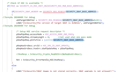

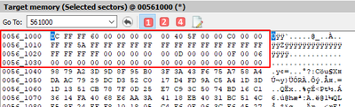

Hi Team
We are using S32K312 chip with below environment:
SBAF:"00 0D 00 00 00 0F 00 06"
HSE:  "00 0D 00 00 02 06 00 00"
We made a similar logic for SBAF upgrade which refer to the demo software and API manual.
How ever, the MCU become brick once we send "HSE_SRV_ID_SBAF_UPDATE" request with one-pass mode into MU, and cannot connect JTAG any more.
*The power supply is stable during the upgrade process as 12.5V to whole ECU.
Is there any debug hint to identify why SBAF upgrade request fail? and any recommend failsafe logic?
