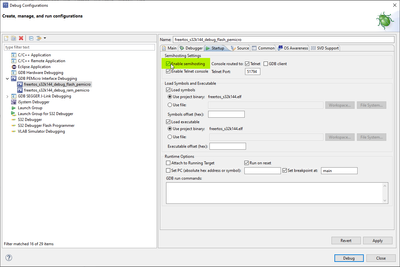

How to enable printf support in FreeRTOS. I am using S32k146 and segger debugger. I want the prints in Debugger console. Though I use newlib and nanolib I am not able to get the prints. Please help.

I had already seen those links in NXP forums. I am using newlib_nano debug console. Is it that I need to use EWL_c debug console instead? Also my telnet port is 2333 and the link says telnet port should be 51794. What is the correct settings here? I have followed your links, checked and configured accordingly but I am using S32 DS V3.3. The link talks about some version lower. Also I do not get semihosting enabled messages in the debug console or console. This is what my worry is. Please help.

PetrS
beside the C lib supporting debug console you also need to enable semihosting console in debug session settings. You can refer to e.g. below thread

jiri_kral
for me it is not clear - are you trying to use remote terminal (like putty, realterm etc. connected to uart) or semihosting console - which forwards printf output to S32DS semihosting console window?

jiri_kral
please make sure that you enabled Semihosting console in debug configurations:

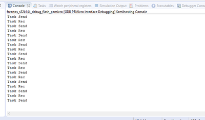

And check, if you are using STDC library with Debugger console support:
If all is set correctly, semihosting console should work:
