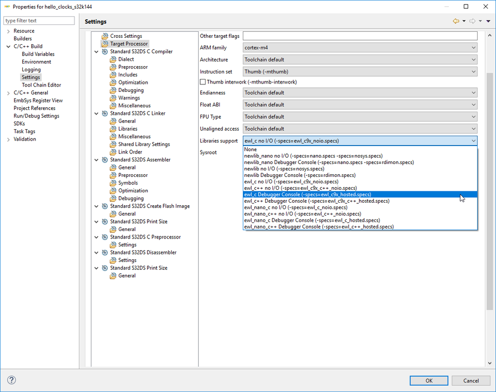

jiri_kral
if you are okay with debug console only - just switch in project properties your actual c library from no I/O version to version which supports debug console:

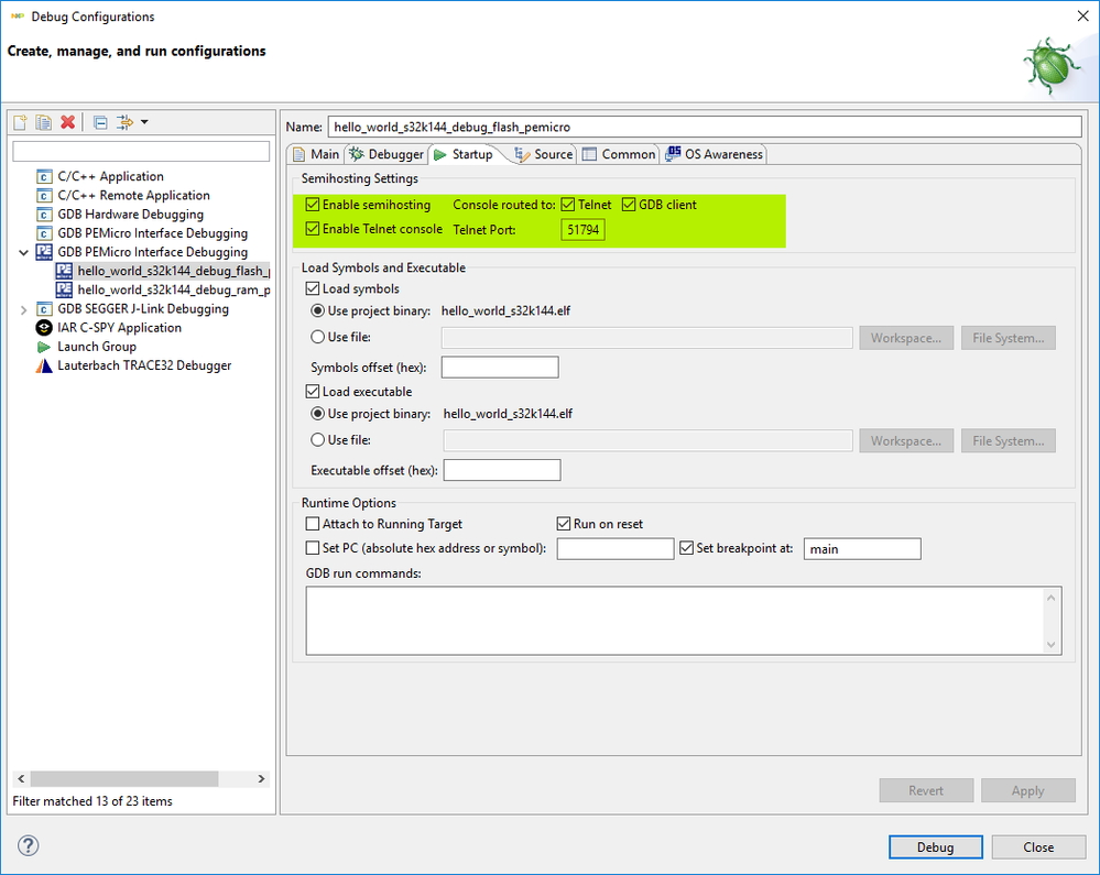

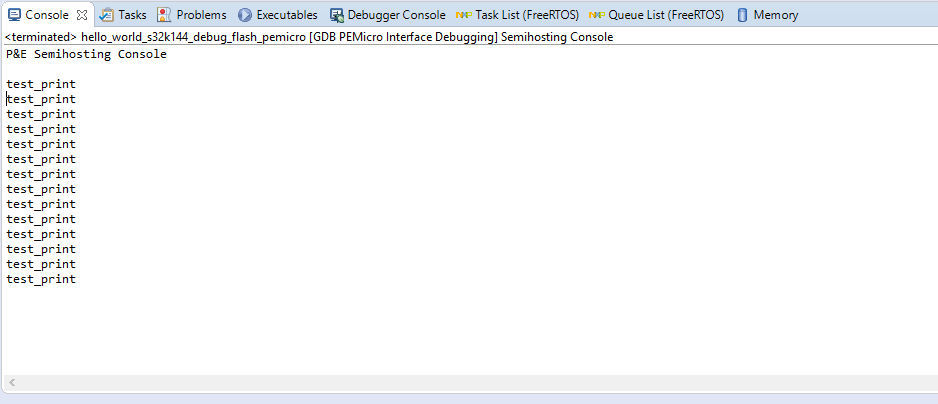

jiri_kral
I forgot also mention that together with C lib supporting debug console you also need to enable semihosting console in debug session settings:
The printf output you can see in console:
Hope it helps.
