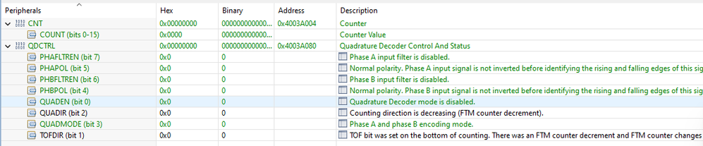

Raghu96
Hi Leo,
Thanks for replying.
I'm trying with a different motor and so changed most of the motor and encoder parameters.
We are not able to rotate the motor and also we were not able to read the encoder values. Even, QUADEN bit of QDCTRL register of FTM2 is not going high.
Jumpers JP9,10,11 are in 1-2 (FOC-PMSM). encoder is 5V. J8 is not connected.
What should be the way forward.
Thanks & Regards
Raghu
864 Views
_Leo_
Maybe you do not have R168 and R166 in your S32K144EVB
