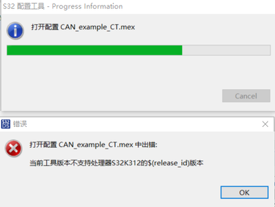

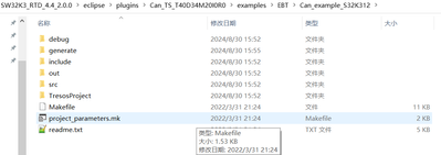

my S32DS version is V3.5, and my chip is S32K312, RTD version is SW32K3_RTD_4.4_2.0.0, i import the example Can_example_S32K312.when open the .mex file ,it report a error as below. i want to know which version of RTD i can used for S32DS3.5,because i want to study  can cfg in S32K312

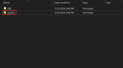

If you are using S32DS, you should use the "S32DS" folder instead of the EBT, those examples are for the EB Tresos platform.

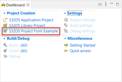

You can also use the S32DS Project from Example option:
