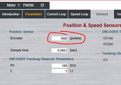

  • In FreeMASTER, Sensors tab define the resolution of the encoder (in my case 1000 pulses).

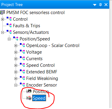

  • In the Project tree, go to Encoder Sensor/Speed

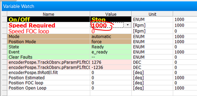

  • In the variable watch define the speed required
  • Finally change the state from STOP to RUN

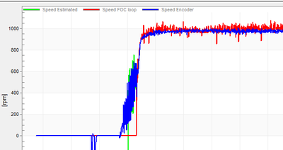

  • And you can see the speed in encoder mode in the scope.

Thanks for your answer. I  tried your solution and I can see encoder speed value but I could'nt run motor with encoder mode. when I switch to encoder mode motor was vibrating.
How can I run motor with encoder mode
