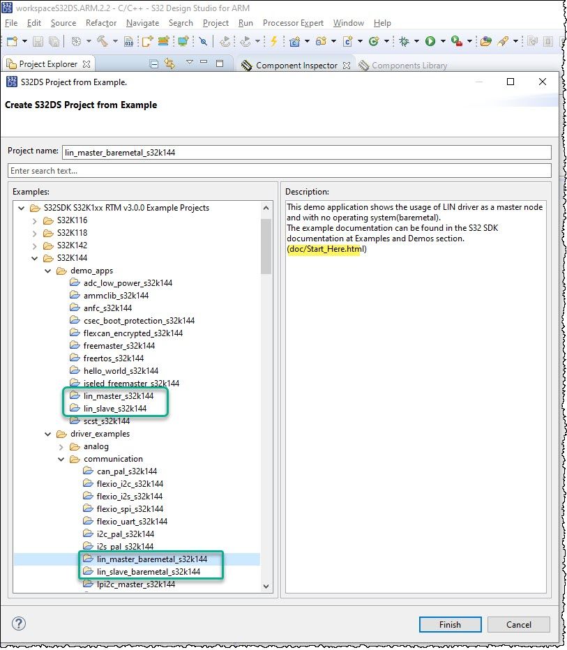

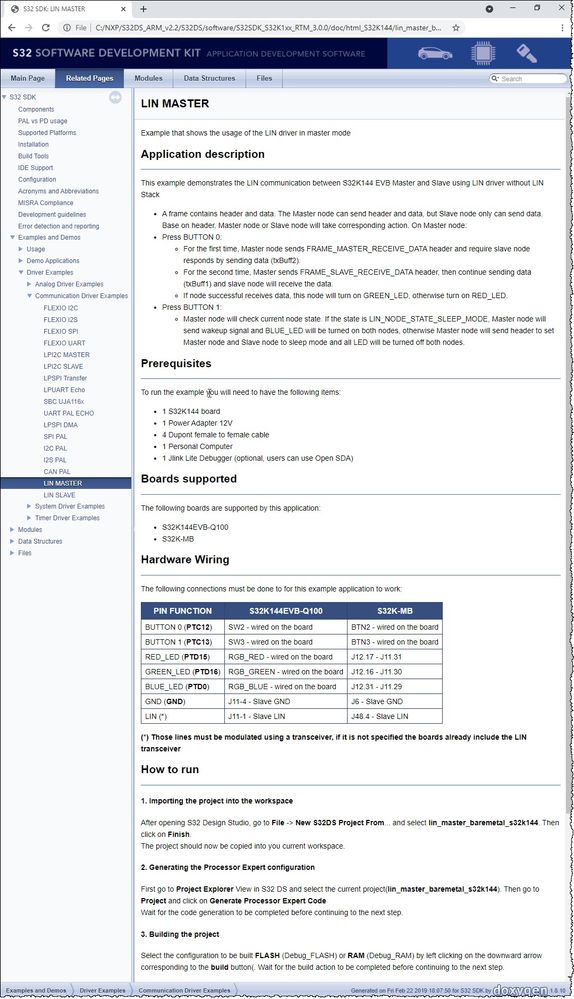

Hi kalajiao,
There are several LIN examples in SDK. Would you please test it by follow the example documentation:
