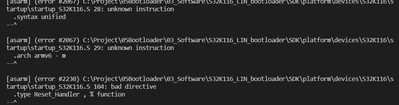

Currently i create a project with IDE S32 DS, but i wanna change it to Green Hills. When i setup a make script with scons, it remind me that the startup file have some errors, e.g
So how to covert a project created by IDE to GHS? Is there have any guidelines? Or where can i get the startup file for S32K116 with GHS?
