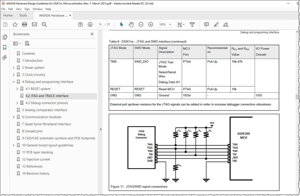

Robin_Shen
If it's your custom board, then please check the SWD connection by refer:AN5426: Hardware Design Guidelines for S32K1xx – Application Note
If you are using S32K148EVB, have you tried to debug it with onboard OpenSDA?

LSLLL
Thanks for your reply,it's my custom board,I use multimeter check the SWD connection and it's no problem.
