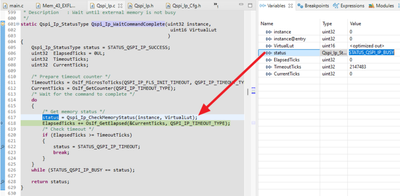

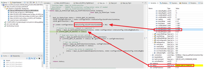

  • Trouble:
    • if I used the AutoSAR R21-11 on 344EVB, it still has the TIMEOUT ERROR.
    • But AutoSAR 4.4 was OK as above description P24, D2405.
    • we tested QSPI on S32K344 EVB and complete rework.
  • SDK version:
    • AutoSAR: R21-11, P14, D2403.
    • SDK: 3.5.13
  • Test result
    • Status is Busy & timeout in Qspi_Ip_InitProtection()
    • Status is Busy & timeout in Qspi_Ip_WaitCommandComplete()

    • Status is Busy in Qspi_Ip_CheckMemoryStatus()
    • Status is Error in Qspi_Ip_ErrorCheck()

Hi @Jireh
First of all, hotfix builds are not fully qualified and are not designed for production; replace them with the next qualified standard version. Please test it with the updated SW version.
Did you make any modifications to the example code? With the SW update does it have the same behavior?
BR, VaneB

2,812 Views
VaneB
Hi @Jireh
As previously mentioned the hotfix sw versions are not fully qualified, you can download the software versions RTM qualified from S32K3 Standard Software > Automotive SW - S32K3/S32M27x - Real-Time Drivers for Cortex-M.

Jireh
Hi @VaneB ,
thanks,
we changed to this version and used D2405 sample code, it was working.
