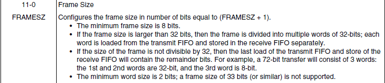

4,871 Views
danielmartynek
It depends on the slave specification, however, in general, you will need to send a 24-bit frame to get the data from the slave. To do this, change the SPI command by a 32-bit write to the TCR register, FRAMESZ = 23, and send the frame.

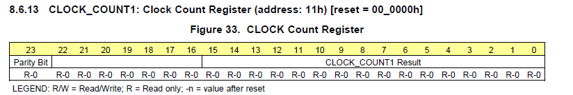

jinshuaixu
Contributor V
    sometimes,I need read 8 bits data,sometimes l need read 24 bits data,in SPI init functin void LPSPI0_init_master(void),how I  to set  TCR register  FRAMESZ ? it should be setted 15 or 31? or when  this time read 8bits data,I reinit void LPSPI0_init_master(void)TCR register  FRAMESZ is 15,when  next time read 24bits data,I reinit void LPSPI0_init_master(void)TCR register  FRAMESZ is 31?
      the chip register  l use is below......

danielmartynek
The command can be changed as needed in run time.
It does not have to be set in the init function.
Please read the description of the TCR register in the RM rev.9
Section 49.3.1.15 Transmit Command Register (TCR).
