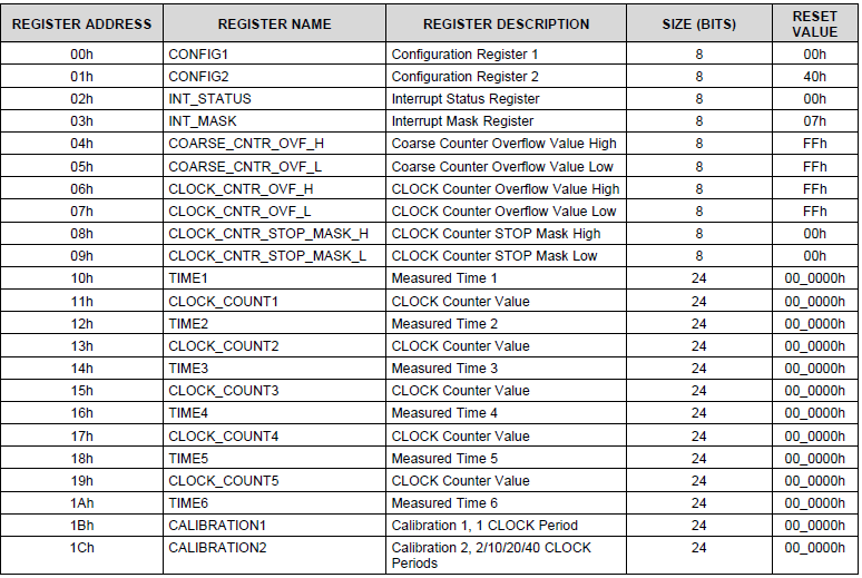

      l need to use SPI to read/write sensor chip recently. SPI control show in below.
    SO  l set SPI  TCR Frame Size is 16bits. my  SPI init and read function is below.

now  l want read 8bits data sometime, read 24bits sometime,how l set read function. set as below????

It depends on the slave specification, however, in general, you will need to send a 24-bit frame to get the data from the slave. To do this, change the SPI command by a 32-bit write to the TCR register, FRAMESZ = 23, and send the frame.

    sometimes,I need read 8 bits data,sometimes l need read 24 bits data,in SPI init functin void LPSPI0_init_master(void),how I  to set  TCR register  FRAMESZ ? it should be setted 15 or 31? or when  this time read 8bits data,I reinit void LPSPI0_init_master(void)TCR register  FRAMESZ is 15,when  next time read 24bits data,I reinit void LPSPI0_init_master(void)TCR register  FRAMESZ is 31?
      the chip register  l use is below......
