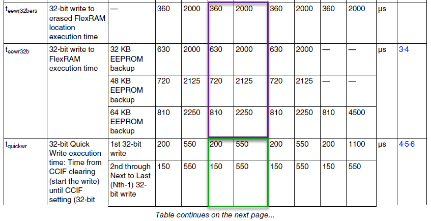

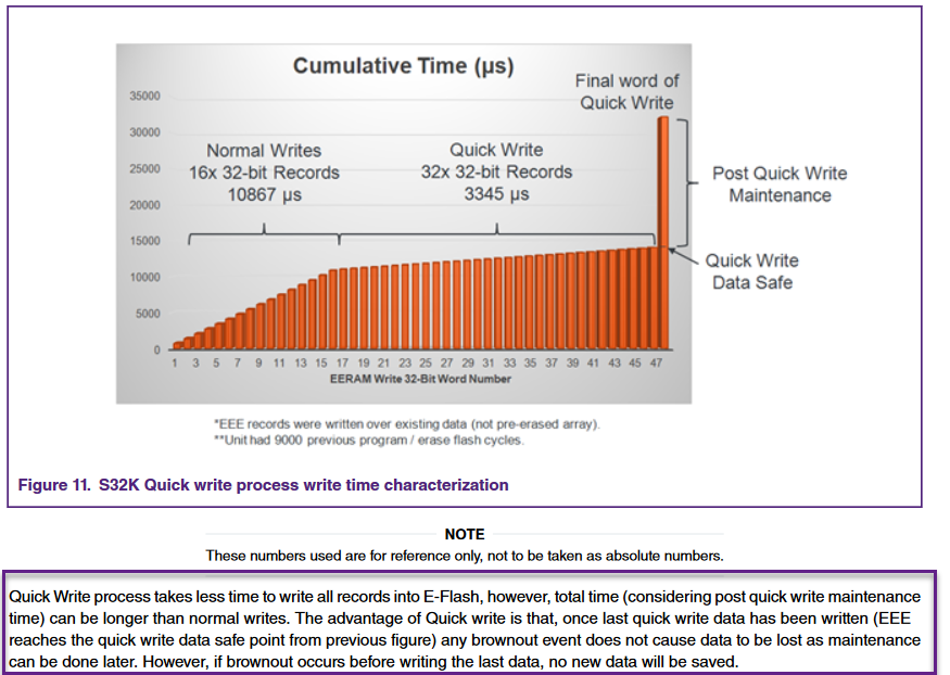

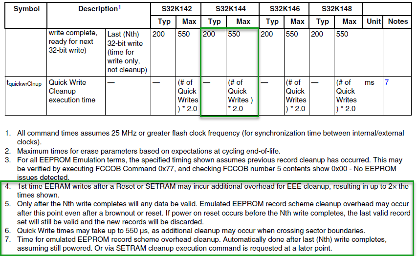

Please have a look at the S32K1xx datasheet, rev13, Table 35.
You can estimate the max. execution time for 128B of normal writes and 128B of quick writes (including the cleanup after the last write).
AN11983 Using the S32K1xx EEPROM Functionality
The code that posted measures not only the execution time of the quick writes but the SetFlexRAM function and the SW overhead of the driver as well.

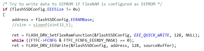

xieyinghui
Hi Daniel,
when i call this way:
void eeprom_write(....){
            ret = FLASH_DRV_SetFlexRamFunction(&flashSSDConfig, EEE_QUICK_WRITE, 128, NULL);
            while ((FTFC->FCNFG & FTFC_FCNFG_EEERDY_MASK) == 0);
            ret = FLASH_DRV_EEEWrite(&flashSSDConfig, relAddr, 128, src);
