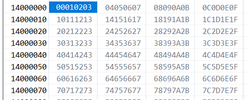

xieyinghui
Hi Daniel:
I know I can write the data in, but the writing speed is the same as normal mode.
In normal mode, The 128bytes I tested are 12~13ms, and the 128bytes I tested in the fast mode you gave me are also 12~13ms. Is this reasonable?

danielmartynek
Hi [email protected],
Please have a look at the S32K1xx datasheet, rev13, Table 35.
You can estimate the max. execution time for 128B of normal writes and 128B of quick writes (including the cleanup after the last write).
AN11983 Using the S32K1xx EEPROM Functionality
The code that posted measures not only the execution time of the quick writes but the SetFlexRAM function and the SW overhead of the driver as well.
