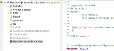

env: S32DS3.5 + RTD4.0
I open Built-in examples--“FlexCAN_Ip_Example_S32K344”,I find  there is no configuration regarding the pins.Is it right?Does it uses any default configuration?How can I find them.

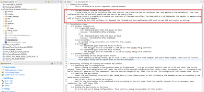

The FlexCAN_Ip_Example configures the FlexCAN instance as loopback, send frames through ISR and receive as polling, as explained in the description.txt file:
Meaning no pins are configured for it. You can change FlexCAN to "Normal/user mode" and configure PTA6/7 for CAN_RX/TX. You can refer to community examples:
