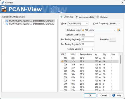

This post presents two complementary FlexCAN communication examples for the S32K3X4EVB-T172 evaluation board, showcasing both low-level IP layer and AUTOSAR MCAL layer implementations. These examples are basic routines for configuring the component in normal/user mode, as the RTD examples are configured for loopback mode.

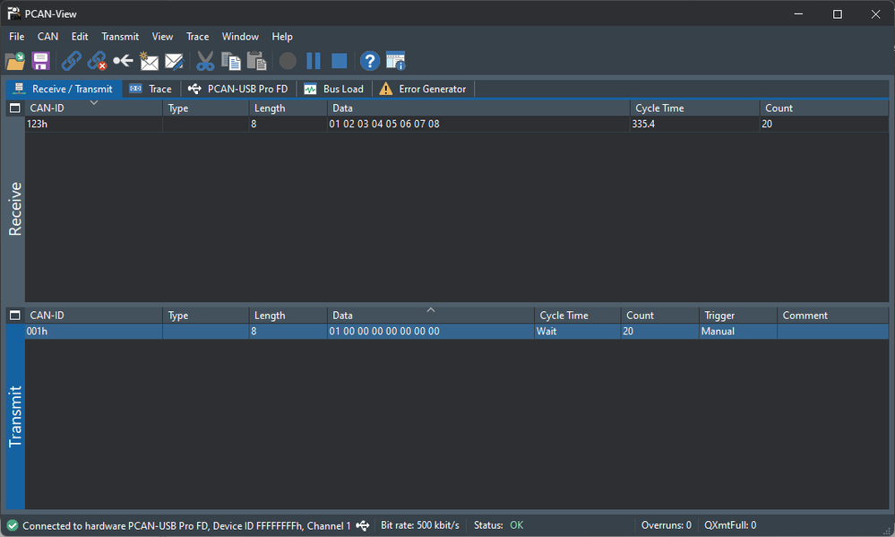

To test CAN communication, another board or a CAN analyzer must be used.
Since Rev. B2 of S32K3X4EVB-T172 was used to test the project, TJA1043 transceiver is mounted on the board and used to test the examples.

Rx Filter mask type is individual and set to receive STD ID 123h
Tx MB is set to STD ID 001h.

CAN messages are sent using Can_43_FLEXCAN_Write() and received using the CanIf_RxIndication() callback. After CanIf_bRxFlag is set, an ACK message is sent back. The GREEN LED toggles every 10 received messages.

Julin_AragnM_0-1768503828389.pngPCAN-View configuration
Julin_AragnM_1-1768503835901.pngPCAN-View message logs
