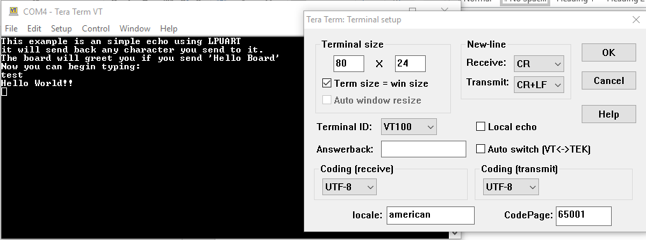

hey guys,
I have been using this lpuart_demo app from the example domain of the S32K SDK and have been unable to get an echo of what I type.
I have tried sending 'Hello Board' with:
1) Newline ending
2) No line ending
3) Carriage return
4) Carriage & Newline both
but there's no reply! from the EVB.
Kindly, suggest what might be the problem!?

as Rares wrote, please specify the MCU and SDK version.
I have tested the "lpuart_ech0_s32K144" example (SDK 0.8.6) on the S32K144EVB-Q100 and it is working well. Only you need to properly setup the PC terminal. Besides of 115200 8N1 setting, It must add the \r\n once you press ENTER. After that the sent data is echoed back.
BR, Petr

nishantsood
It is SDK 0.8.6 only ,What Happened is that I think the PTC port is what is used for this example and RX is not working on it, maybe my particular hardware fault but I did implement this on another port and it started working!
4,284件の閲覧回数
freddy_ben-zeev
I've found out from NXP that this happens only on the EVB board because LPUART1 connects through PTC6 and PTC7 to a debugger chip which allows a console in the debugger. When I've connected PTC6 and PTC7 to my FTDI-to-USB adapter PTC6 is driven from two places. If you want to still use these pins to interface with external console you would need to remove an resistor to disconnect it from the debugger chip.
