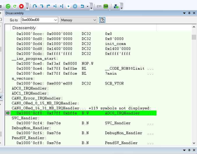

Hi Lukas,
Thanks for the reply I have ported the code of boot loader code to IAR.
Now I am able to write my application code to the flash memory
but the boot loader is not jumping to the application code it is showing Hardware fault.

Can you suggest me where am I going wrong.
3,385 Views
lukaszadrapa
the linker files don't help...
Did you disable all interrupts before jump? It's necessary to disable globally and also disable all local enable bits. It's good practice to put everything to default state before jump.
If you step asm code, which instruction does cause the hard fault?
Lukas
3,385 Views
shubhendu_shukl
Hi Lukas,
Thanks for the reply.
We are disabling the interrupts before jump. Please find the below code.
After the execution of jumptoUserApplication()
the code is getting stuck in AC0_IRQHandler().
Please help me where am I going wrong
