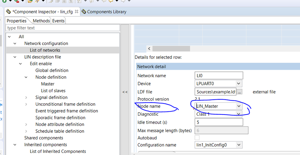

Dear Expert,
S32 Design studio Version: 2018.R1
Build id: 180815
While creating new project -> LINStack module configuration (Editing Component Inspector )
Node  Name -> Always listing Master Node ID, slave node IDs not listing.
But my goal is to configure Node with slave node ID.
Please see the attachment
Could you please help me

LIN slave is configurated in the S32Design Studio example project (lin_slave_s32k1xx) you can use it as reference.
Diana

With ref. of the  the below question i got answer for my question.
Answered old post "How to configure LIN Stack for a Firmware which shall support more then one slaves on Bus?
