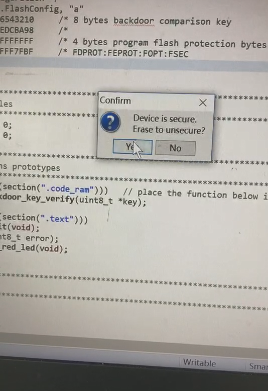

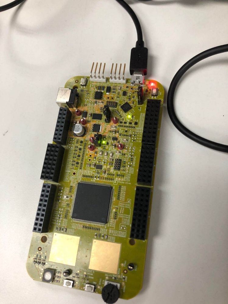

hello, now my device S32K146 state as the first picture , D1 LED is light always.
Debug status as the second and third pictures, press "Yes" in the second picture it will jump to the third picture,  then press " retry"  in the third picture, it will jump to the second picture.
how can i resolve this problem?

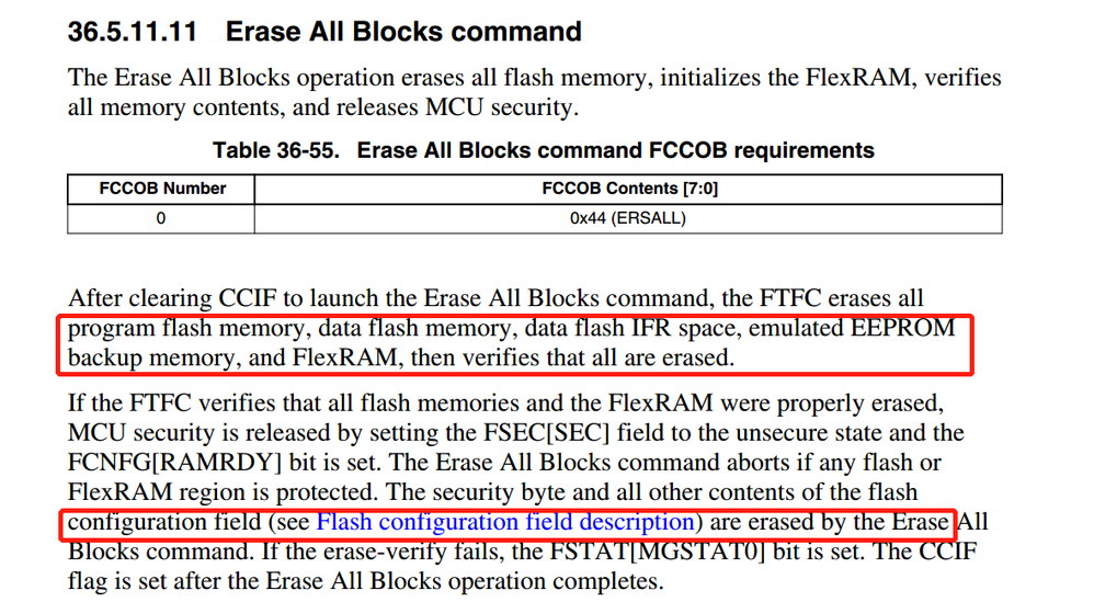

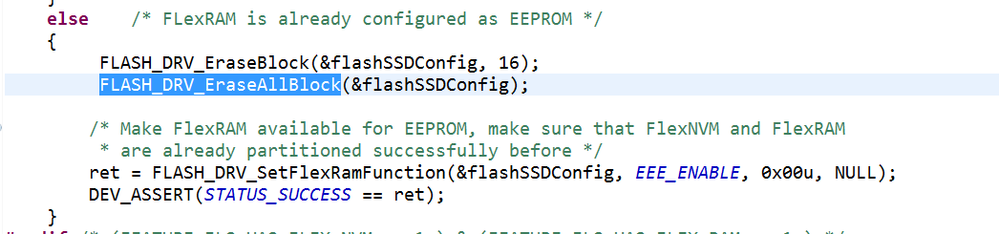

   I remember that execute the following code
     this is my test code, after this operation, The device  security.
from the manual i found configuration is erased after execute erase all block command , so all the following data is changed to 0xFF, when reset the device is secured,  MEEN = 11b, KEYEN = 11b,SEC = 11b.
current device is secured so this command executed succcessfully. so it is no need to consider whether to enable CSEc.
when switch to KEIL 5, run debug  tips the following
then  press “确定”
    I don't  know why, wish your help

danielmartynek
Hello [email protected],
Please refer to the reference manual.
It has been already discussed, for example, here:
Flash protection S32k144
You can use the Backdoor key feature to remove the protection without erasing the MCU:
Example S32K144 Verify Backdoor Access Key S32DS1.3

danielmartynek

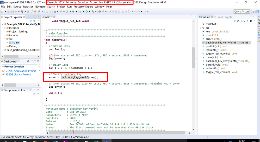

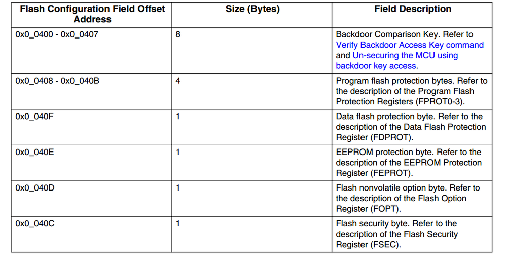

I believe that it is explained in the example.

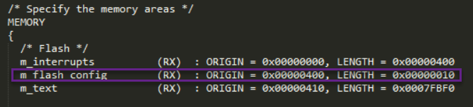

The backdoor key is defined by the user in the startup_S32K144.S file.
At 0x400 in the S32K1xx_flash.ld linker file.
The Backdoor Key Verify FTFC command (0x45) can be used only if the flash configuration field has the key defined.
The command unlocks the MCU so that the debugger can access the memory/registers of the MCU.
If the key is not defined and the MCU is locked, the debugger can only mass erase the MCU.

814420552
hi  Daniel,
  how can I know the backdoor key?and if my device S32K148 demo board executed erase all block command the
device will be secured, openSDA can't connect with Device  and D1 led keep light, then how can i resove this problem?
if execute backdoor command, but I don't konw the backdoor key.  onthe other hand if i know the backdoor key how can i execute this backdoor command in the deviec?(Debug can't connect)
