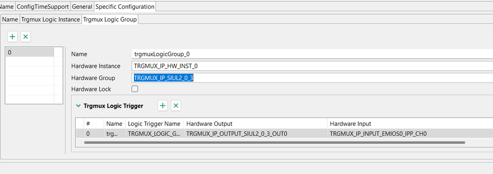

I am trying to read the value from the timer EMIOS_MCL on the oscilloscope.
What is the best way to get the EMIOS_MCL output signel?
1) Trgmux : i am trying to get the signal out  here is my configuration:
Skærmbillede 2024-02-26 100257.pngSkærmbillede 2024-02-26 100307.png I don't have an output: what do I miss here ?

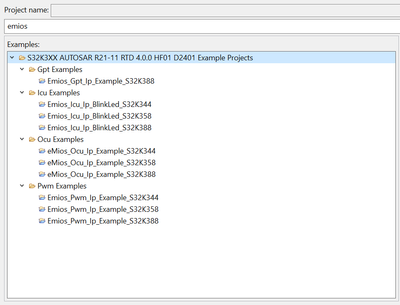

I would recommend firstly trying an example from the RTDs package:

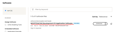

For the timing configuration, you can refer to the routine to set the trigger time inside the development kit application SW: S32K344 BLDC/PMSM Development Kit

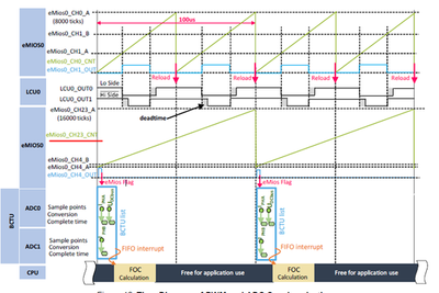

The green signal eMIOS_CH0_CNT starts from 0 until a particular value and then resets to 0 (MCB_UP_COUNTER), the default period range can go from 0 to 65535, which with a 160MHz clock would be from 0 to 410uS.

Thanks for the information ,I only have RTD version 3.0.0 , it is not available to download RTD 4.0.0 for S32K3XX.

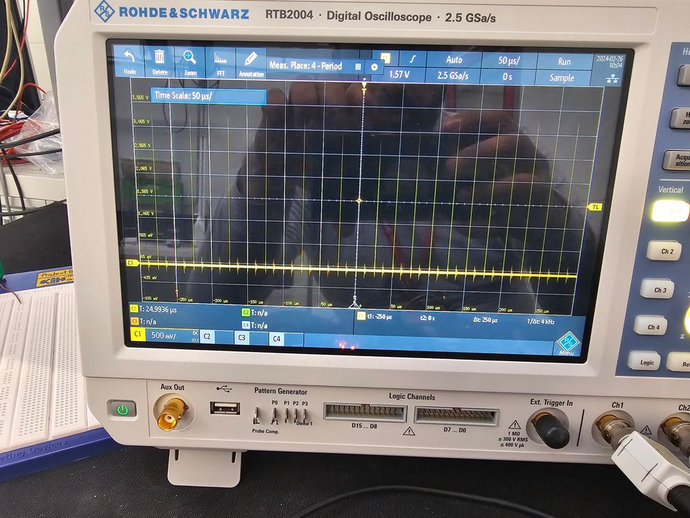

I just need to read the Emios_mcl output on oscilloscope !
when i am trying to connect  the emios to trgmux as seen above, it does not gives any output ,even thought if connect it further to BCTU :
Emios_mcl ---> Trgmux ----> BCTU
the bctu is getting triggered as it should be , but i need to read the signel that is coming out of emios_mcl?
