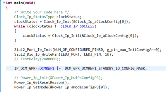

SCoder41
So when my MCU wakes up from standby mode to RUN mode, can I keep the GPIO output high all the time?
1,111 Views
Robin_Shen
Yes. Set the GPIO high and then write 1 to DCMRWF1[STANDBY_IO_CONFIG]:
It is recommended to use an oscilloscope to confirm the pin status.
