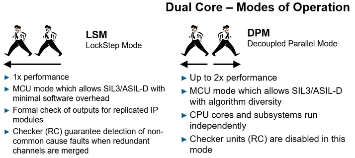

Could you clarify what information you would like to know about lockstep? I am attaching screenshot from some old presentation for different device, where this concept has been used as well.

I've found "Safety concept MPC5643L.pptx" file from freescale. This file includes also the image that you've shared above but still I can't understand of how I can make use of Lockstep feature.
I've grasped the generic idea of what Lockstep is and what it does but I'm looking for the details regarding this feature.
