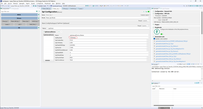

3. In S32DS's configuration GUI, it said the spi baudrate can up to 20MHz, but it can only confige to 15MHz?

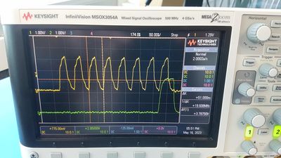

I also test max baudrate in FlexIO SPI setup from example code Lpsi_Flexio_Ip_Transfer_S32K344(In S32DS 3.4 and RTD SW version 2.0.0, build version S32K3_RTD_2_0_0_D2203_ASR_REL_4_4_REV_0000_20220331). When I change baudrate to 15MHz, some how the  oscilloscope shows some 1KHz. When I change to 10MHz, the scope gives 20MHz. Hope somebody can give explanation.
