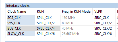

I can confirm that:
- When RUN mode clock is SPLL and when going to VLPS, then the wakeup time from VLPS to RUN is more than 500us.
- When RUN mode clock is FIRC, when going to VLPS, then the wakeup time from VLPS to RUN is around 10us, as stated in the datasheet.
So, it seems that waking up when the system clock is SPLL is much slower than with FIRC.
Could you please confirm our observations?
Why is this difference? Is this the time to lock the SPLL? Is this delay described in the datasheet or the RM?

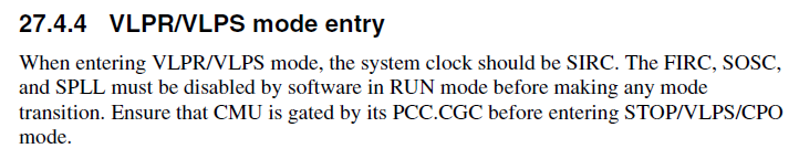

Hello Ricardo,

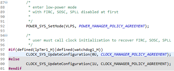

The system clock cannot be derived from FIRC/SPLL when the MCU enters VLPS.
The Power Manager SDK driver switches the clock to SIRC in the Power_SYS_Setmode(VLPS, ...) function.
BR, Daniel

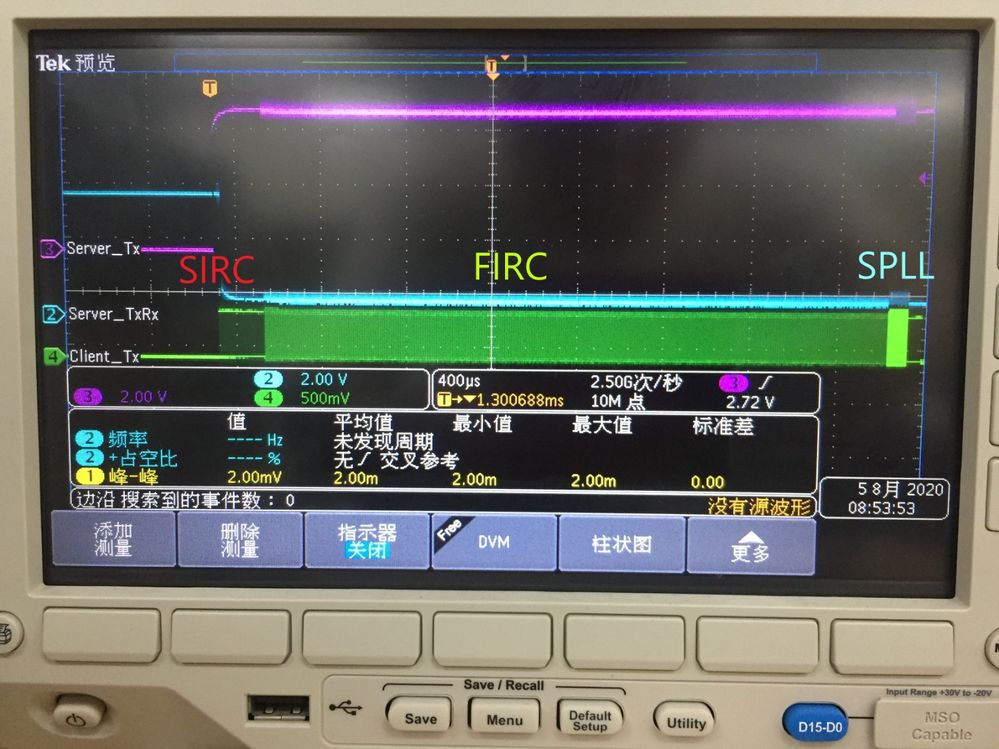

Jeremy_He
Hi Ricardo,
No matter you use SPLL or FIRC as the system clock, the time from VLPS to wakeup PORT ISR shouldn't be affected. The ISR will always be executed before the clock initializing.
Also in the attached project, the system clock will switch to SPLL_CLK. And a clock out pin(PTE10) that connects to the bus clock is used to show the clock initialing procedure. You can test with the code directly.
Best wishes.
Jeremy

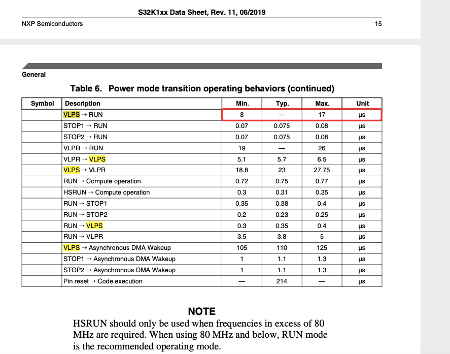

Hi Ricardo, you can find the numbers in the datasheet as below.

Any help or hint would be really appreciated. Because this makes no sense. Why the datasheet states max 17us but we can measure more than 500us.

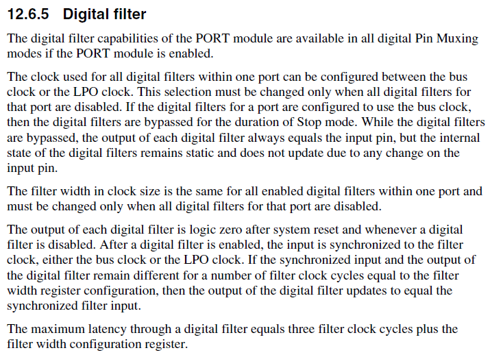

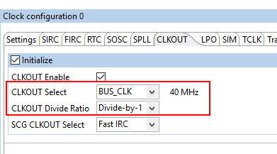

danielmartynek
Hi Ricardo,
One possible reason could be a delay caused by Digital filter on that port.
Could you scope the active edge along with BUS_CLK on a CLKOUT pin?
BR, Daniel

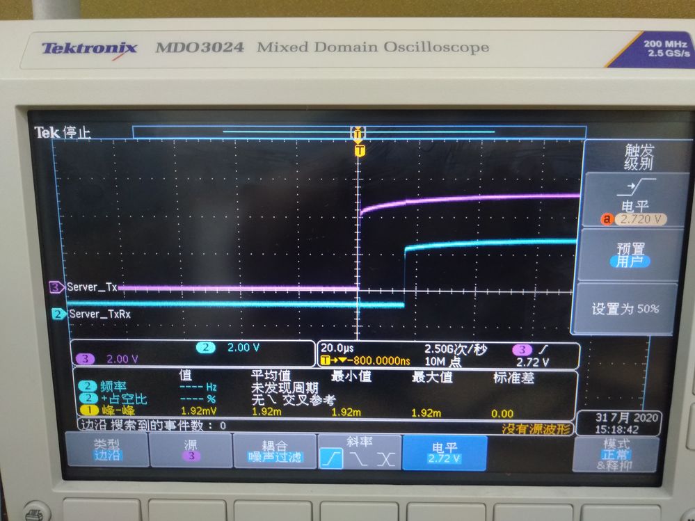

Jeremy_He
Hi Ricardo, I tested with a project using S32K144, The time from GPIO wake up to ISR toggle another pin is around 17 us, which matches the datasheet. Please check your code maybe something else is wrong.
On the below oscilloscope, Channel 3 is connected to the button SW2(PTC12), Channel 2 is connected to BLUE LED(PTD0) which toggled in PORT ISR after waking up from VLPS. Please check the attached project.
