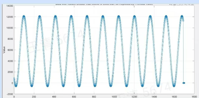

我们在使用S32K396 SDADC转换做旋变测量,发现结果和实际相差较大,大约有100MV。该结果已经过偏置和增益增益标定,计算公式使用的是·(Vin/5V)*32767。使能DSP后误差变得更大,大约300mv。大家有遇到过类似的问题吗?该如何处理?
We used S32K396 SDADC conversion to measure the rotation, and found that the result was quite different from the actual one, about 100MV. The results have been calibrated for bias and gain gain using the formula ·(Vin/5V)*32767. After DSP is enabled, the error becomes larger, about 300mv. Have you ever had a similar problem? How to deal with it?

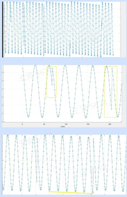

I use the FIFO interrupt of SDADC to transfer the collected data into the data array, and the FIR filter is not enabled in SDADC. I measured a 2V, 10kHz sinusoidal signal and the resulting data array is plotted in the following image.
In this case, SDADC works fine; However, after the FIR filter is enabled, there are problems with the output data. The filtered converted data appears incomplete, with an abnormal downward shift in the signal, as shown in the figure below.

Thanks for the details.
Seems the same issue that this thread:
https://community.nxp.com/t5/S32K/S32K396-SDADC-measurement-of-AC-signals-shows-attenuation/td-p/195...
The inconvenience is that you are using the S32K396-LQFP-DC, and we do not have access to said board, because it is not available in our NXP page, and therefore we cannot debug your issue on our side.
Please check if this issue is reproducible in the S32K396-BGA-DC1? And how?
If not, I'll need to ask you to contact your NXP representative or whoever provided you with the S32K396-LQFP-DC to follow up with your issue please. An apology for the inconvenience.
