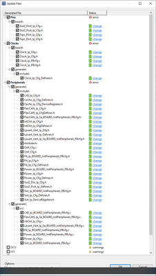

K344 project is made for BGA257 package.
If you open pintools from s32DS, and click "update code" without changing anything, Pintools wants to remove some files from project.
Check : https://prnt.sc/a28m4I2Fea9m
And project compiles gives a lot errors because of that.

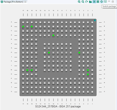

I need to change IC package, because mine is FQFP172.. (ev-kit from nxp)

I have tried to import this project in S32DS3.4 with SW32K3_RTD_4_4_1_0_0_D2110
Project can be compiled first, after I opened configtools and update code, it shows some errors but nothing is removed and update is done, code can be compiled again.
Package switch can be done in Pins configtool
​​​​​​​and you will need to select different pins for some outputs
